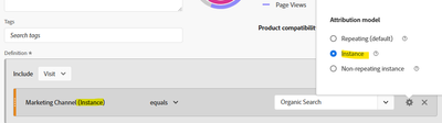

You might want to create a segment something like:
This should isolate Visits that had an instance of Organic Search, but it will still show other Marketing Channels if they happen in the same visit (see Visit 3 above)
 You should be able to use this in conjunction with bounces and time spent... but make sure that the table breakdown isn't going to cause calculation errors...
