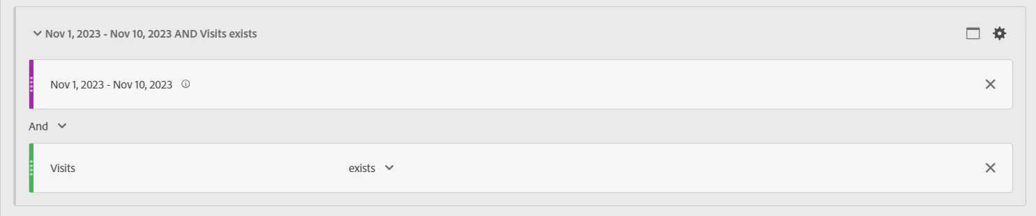

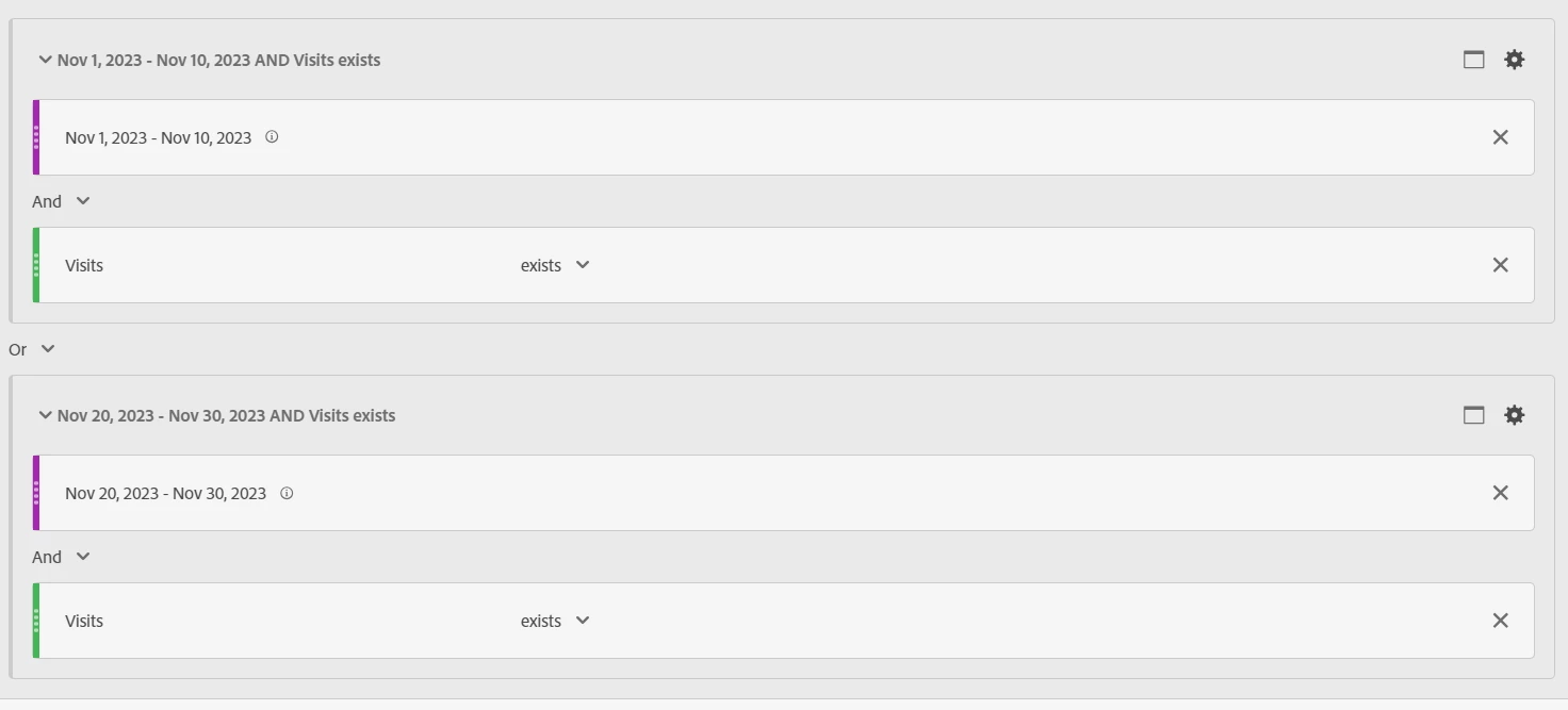

1) If you are looking to create a segment where both the date ranges should be present & you should get the data for the segment when using it. You can create the segment with "or" condition & use the segment to view your data.

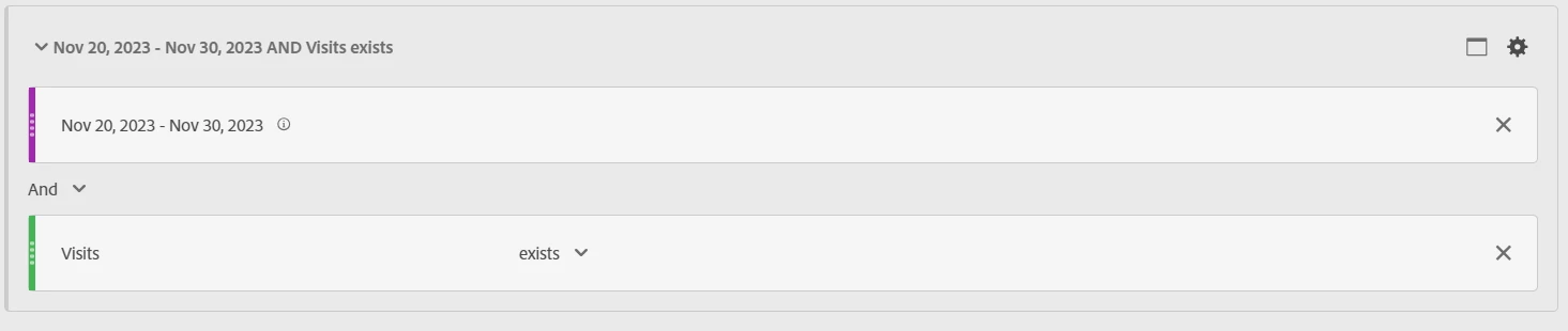

2) If not, if you are planning for comparison kind of thing, you can create a segment with one specific date range & duplicate the same segment by just editing the date range.

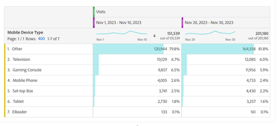

4) As well, you can just view the data in the below mentioned way if required.
