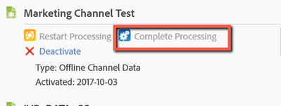

We are trying to import offline metrics in to Adobe Analytics via Data sources. Importing 3 metrics is working fine and we are able to view the metrics data in the reports. Similarly when we import 5 metrics, import status is showing successful but data is not showing up in the reports. Has anyone tried importing more than 3 metrics using data sources. Please let us know if you have any inputs on why the imported metrics might not be showing up in reports.

Our Data Source template only allows users to add up to three dimensions & three metrics but once the template is generated, the users can add more dimensions & metrics. Once the data source upload is successful you will need to select the option of "Complete Processing" for the data to appear in the Analytics reports as shown below.

Hi @kainth,
Thank you for your help.
This worked and I am able to view the data after selecting the "Complete Processing" option.
What I still wonder is that how I was able to view data in the reports earlier when I had imported only 3 metrics and I had not chosen this option. I didn't get any information about "Complete Processing" option in the Data sources documentation. It would be great if you can let me know the link where I can find more information about this.

Hi @mesood
Thank you for your inputs. I had considered above aspects. Selecting "Complete Processing" after the import resolved this issue.Now I am able to see the data in the reports.
