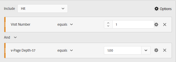

If you really need to put first page-first visit into a variable, setting some launch rules is probably your best approach. You can use a processing rule to set the first page of a visit into a variable, but I'm pretty sure visit number is not available in processing rules (though that would be nice to have).
On the other hand, if you just need to identify first page-first visit pages, you can use a segment. Something like this should work:

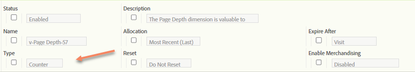

Page Depth uses a counter evar configuration to count how many pages into a visit the page view occurred. That configuration looks like this:

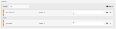

Similar to @RobertBlakeley solution, Adobe should be tracking both Visit Number and Hit Depth automatically. So you should be able to build a segment to get a user's first ever landing page by using:
If you only care about the first page of a Visit, which I believe that plugin would return, then you should just be able to use:
At least this solution shouldn't require using creating a new counter.
