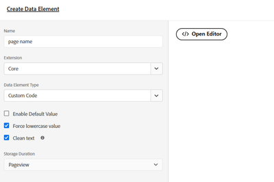

Essentially, I create a custom code Data Element like so:
Then in the code editor, I will code the logic:
