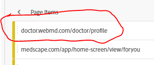

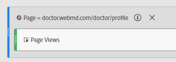

Identify the variable and value in which you track the share click. Divide that by the Page variable and page name of the page in question. For our implementation, it would look like this:
From the component bar find the variable, open the element list and drag the click value or page name onto the calculated metric canvas.

A "share rate" from a page (unless you have complications that we are unaware of) would be a simple "Shares" divided by Page Views for the page.
You can use "Occurrences" as shown by Robert, or if you have a dedicated metric, you could use that.
Now, if you have shares available on many pages, then you can't do ALL shares over page views on the specific page... and this might be where you are getting stuck... and this will very much depend on what data you are collecting on your "Share" action.
Let's say you have shares available on Page A, B and C.. and you want a share rate only for A...
You would need to segment out "Shares on Page A" / "Page Views of Page A"
