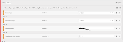

I have started working with data feeds and I am not re-creating segments that we use for reporting, whilst I do not have any issues with visit and visitor level segments, I am somewhat struggling with hit based ones.
Below is an example where we exclude some hits based on the following criterias:
Any idea on how to get time spent per visit - granular and content time spent in data feeds?
