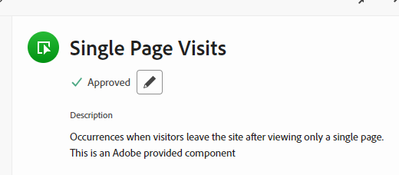

For the first and third cases, you could create a metric using "single page visits" and a segment that either includes/excludes seeing that pop-up. For the second case, does a second page load call fire after they accept the disclainer and see the page? If not, then the same method would work, again just modifying the segment.
Single page visits is a default metric from Adobe.

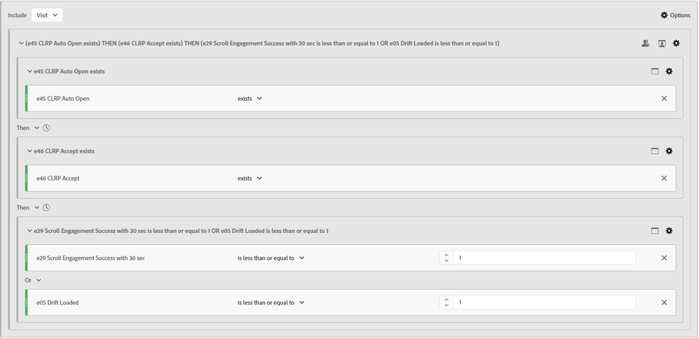

I think this "hard bounce" might be something more like:
VISIT [
    e45 (Auto Pop) exists
    THEN
    Container HIT Exclude [
        e46 (Accept) exists
So this should capture the visits where the popup was shown, but the user did not accept the terms...
Your "Soft Bounce" might be something more like:
VISIT [
    THEN
    e46 (Accept) exists
And your Returned Bounce should be fine, you are excluding the "e45 (Auto Pop)", you could use exists, but exists vs greater than or equal to 1 should act about the same.

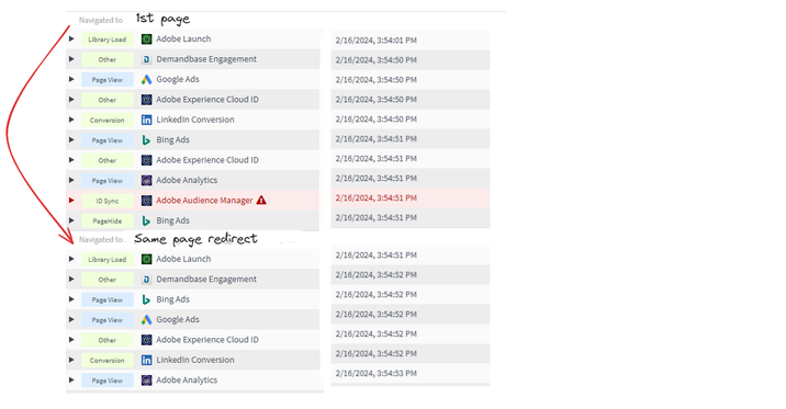

Someone lands on the site and sees the popup, and presses Accept - this is what happens:
1st Page Load Beacon fires, including events 45 (popup viewed) and 46 (accept pressed)
immediately, it then fires
2nd Page Load Beacon
i know its no longer a bounce now.  That's why we have this issue.
I believe the site behaviour logic was set because when someone arrives, they are served a country website that is best appropriate for their location.  However, we have for example 15 different country websites for EMEA alone so if someone changed their country (for example), it would force a URL change and therefore site navigation.
We can't get in between the 1st page view and 2nd page view, because its set to fire one after the other. I can have another conversation with the dev team on what is possible. But hopefully it can explain some of the challenges i face.

OK, I understand the extra page view for changing location, that one makes sense, you are technically loading a new page in that flow.
And, ha... what is an implementation without challenges?
So it's actually reloading the page when the user accept the cookies... hmm that is a challenge..  but it's always the same page? Or are users also choosing a location on your popup that forces them to potentially another URL?
If it's always the same page, we might be able to use the calculated "reloads" in Adobe to help build in logic on the rule... but this only works if its the same page, and not a location specific variant change.
