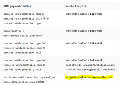

Hi John,
Yes this helps a lot.
You asked:
"For your first example that shows up in reporting, is there any reason why you need to map the same field (_experience.analytics.customDimensions.props.prop36) to itself?"
I was surprised I had to map it. it doesn't work unless I do. This might be because I didnt send the proper web.interaction or webpagedetails information below. Maybe the data got dropped. Im gathering information to send another test event soon. Maybe for the next round, mapping won't be needed for this

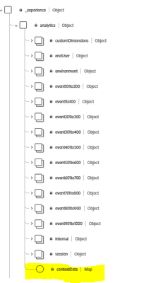

I think it's what we're looking for. How is it structured? and where does it live in the xdm structure? Could it be anything custom or does it need to be something specific like: _experience.analytics.contextData
or simply
_contextData?
Does it relate to this field?
Is this the sort of mapping you're referring to?
_experience.analytics.contextData.customValue

@BertBru
For Option 2, I think you can just place the context data in the top level of your payload.
