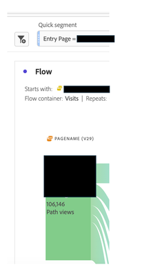

1) Does adding a page to the 'Starts with' column mean that this is an entry page? Looking at the numbers in my freeform table and the flow, makes me think it is similar. However, when I trend the first column and then look at the data source and the segment of it, it does not include 'Entry Page'.
Since I need to apply a segment to the Flow, I wanted to test it first with a plain dimension and tested it by adding the entry page onto the panel. I expected that both, freeform and flow would not change since they are already are based on the entry page. As expected, the number in the freeform did not change but the number in the flow did massively:

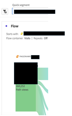

I then added another dimension, the one I would like the flow to filter by eventually. While the number in the freeform table makes sense, the number in the flow is now much higher.

1. Does the 'Starts with' column in Flow correspond to the Entry Page? And if yes, why does it change drastically when I add the entry page to the panel quick segment? If it is not the entry page, how does it differ?
2. Can I use segments in the top panel with Flows or if no segments, can I use simple dimensions?
