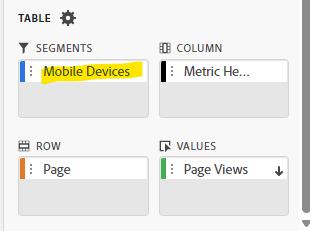

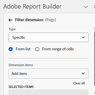

I am new to using the Adobe Report Builder add-in in Excel. I would like to be able to filter a dimension with a segment, but that does not appear to be possible. When I drag the segment and drop in on the "row" with the dimension, it won't stay. When I select the ... the only options I am given to filter the dimension are
When I select the drop-down for Type, it gives me the option of specific, but when I select it, the items it gives me are specific to that dimension. Is there any way to be able to filter a dimension by a segment? Thank you!

Filters on the other hand can provide some basic filtering without the need to create a whole segment, think of it sort of like using the filtering on your Workspace table:
So Filters are limited to "Most Popular" (i.e. the top X items by metric), or a specific list of items (that you can curate here in the settings, or pull from a range of cells)
This can actually be handy if you want items to always show in the same order everytime the report runs (and not be swayed by the metrics). For example, my global suite has 30 websites... on my monthly report, I curate the server list so that the sites always appear in the correct order, so that there is consistency in the display, and my MOM calculations.
If you don't care about the order, you it will default to Most Popular... you can change this from 10 to a higher number... but you cannot pull "unlimited"... if you need to pull everything Report Builder is not the correct tool for the job.

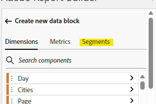

Using a segment would be used like so:
Segments is it's own section, not part of the dimension filtering..
If you need different segments for different dimensions, then you need to make a new Data Block for each pull...
This does make report builder a little more complex than Workspace. Basically each Data Block is a separate API call, and segments are applied to the whole, not just the column.
