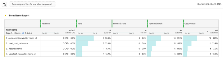

2. The recorded `Form Name` will then be the reported in Analytics:

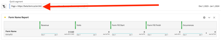

3. But when I add a segment to only see the Form Name from "https://beta.form.ca/en.html", the data are gone. Note that I am using the `Page` dimension as that is where the URL values are being recorded, and I don't have the `Page URL` dimension.
To sums up, all forms were submitted from the intended page URL "https://beta.form.ca/en.html", and correctly recorded. Yet when I filter by that same URL, the data are gone, as if the `Form Name` eVar is not tied to the page URL.

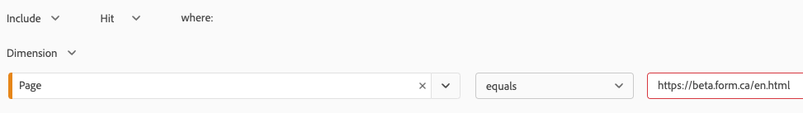

@sean12341 Your segment is still making use of the Page dimension as per the above screenshot. Change it to the eVar4 you've setup to capture the pagename and make it a visit level segment cause the form start and submission does not happen in one hit but in a visit (it the form is submitted during a visit)
Hope that will sort it out for you.

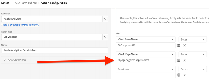

I tried to use the eVars to capture Page Name per below.

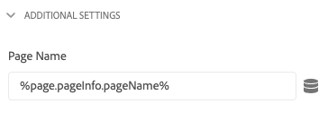

Another `Page Name` was also captured further down(not sure if this create a duplicate issue)

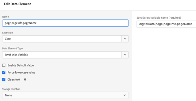

Here is the definition of `page.pageInfo.pageName` element.
And here is segment definition in the Analytic report:
But I am still getting the same issue, where the data are collected, but are gone when I include the above segment.

"Page" (as in the standard pageName) isn't available on Actions, it's removed by Adobe during processing (see my answer below).. you would need to use your eVar in your segment definition:
Page Name (eVar4) equals https://beta.form.ca/en.html
