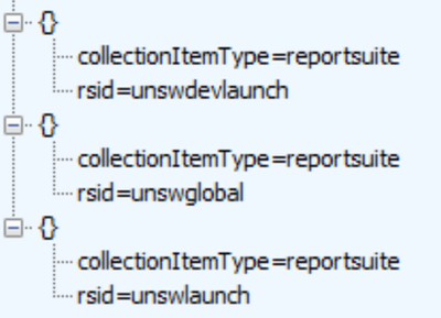

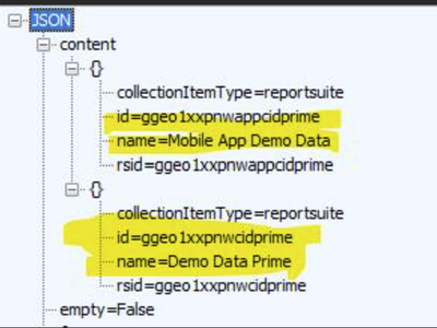

It appears that the collections/suites endpoint is not returning all the data it is supposed to.  This is an issue on Adobe side.  The API is supposed to return collectionItemType, name, id, and rsid, but it is currently only returning collectionItemType and rsid.
working version:
Non-Working:

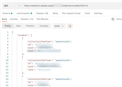

I believe the API that is being called in Connector 2.0 is - https://analytics.adobe.io/api/{global-company-id}/collections/suites?limit=0
So, I made a similar API request outside of Power BI, to see if we are getting the same response from the API, but I can see ID and name as well. My wild guess here is maybe Microsoft is modifying the response that is being retrieved or something might have changed in the latest version.
