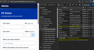

Sure, I also tested on https://www.allstate.com and https://purchase.allstate.com/ and can confirm that the ECID is set on the root domain .allstate.com, so that looks fine. But, the site https://shopandbuy.allstate.com isn’t accessible for me where you are having this issue as it redirects to https://purchase.allstate.com. If you can test on that domain https://shopandbuy.allstate.com and verify that it uses the same ECID as shown below & on AA call as well, then cross domain tracking with the same ECID is working as expected fro most of your traffic. Test in incognito where the browser doesn't accept 3rd party cookies like safari/incognito etc.
See the attached images. ECID remains same.
Adobe Champion
mid is visible only in ECID2.png, not in ECID1.png. vidAPI looks like a custom Allstate implementation, maybe for visitor ID. But yes as long as MID is present and is the same, the ECID service is working.
MID can also appear if the Visitor ID Service is half working... but that I mean that the call to the Visitor ID service is made, and an MID is set, but if the cookie fails to save, it will only work so long as you are on the one domain in the one visit...
So making sure the s_ecid cookie is actually set is very important... but like I said, I did see it in my testing... but bots may be restricting cookies, which might result in that behaviour...
And given the odd browser and the AWS IPs... it seems like that might be the case...
