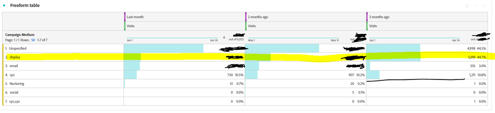

Recently we found the attribution of traffic source might not reflect the reality.The display traffic became much lower than search before, which is very unlikely according to our google ads data. We did not change ads budget allocation that much between search and display ads.

Hi @jiayingPa1 ,
This usually points to attribution or tagging issues, not an actual drop in display performance.
Possible reasons:
Adobe Analytics relies on tracking codes (e.g., cid, utm_campaign, gclid) to attribute traffic.
If display ad URLs aren’t tagged correctly (or if redirects strip those tags), Adobe may:
Attribute traffic as “Typed/Bookmarked”, “Other Referrers”, or “None”
Or group it under Organic or Direct
Adobe uses Marketing Channel Processing Rules to classify traffic. If display ads don't meet the rule logic, they may be misattributed.
For example:
If your "Display" rule is placed below “Paid Search” or “Referral”, traffic could be wrongly assigned
Or if it's based on referrer instead of cid, it might miss GDN placements
Check display ad links for:
Correct tracking parameters (cid, cmpid, etc.)
That the parameters persist through redirects or landing pages
Review your Marketing Channel Processing Rules:
Make sure Display is defined correctly, typically with:
Tracking Code contains=display
Or Referrer contains=doubleclick.net or other DSP domains
Ensure Display rule appears higher than broader rules like “Other Advertising” or “Referral”
If using auto-tagging (e.g., gclid ), Adobe doesn’t natively parse gclid. That’s a Google Analytics feature.
Use manual tagging for Adobe (e.g., cid=display_campaign_xyz)
Or ensure gclid values are mapped via Processing Rules or Classifications if using a hybrid setup
Adobe expires tracking codes after a default period (e.g., 30 days). If a user clicks on a display ad and returns later without the tracking code, their session might be attributed to Direct instead.
Check your tracking code expiration settings in:
Admin > Report Suite > Conversion Classifications > Tracking Code Expiry
If bot rules are updated or corporate IPs excluded recently, traffic might get filtered out more aggressively
This affects impressions or clicks from display-rich environments
Confirm whether bot rules or internal traffic filters were changed recently
Hope this information help you.
Thanks.
Pradnya
