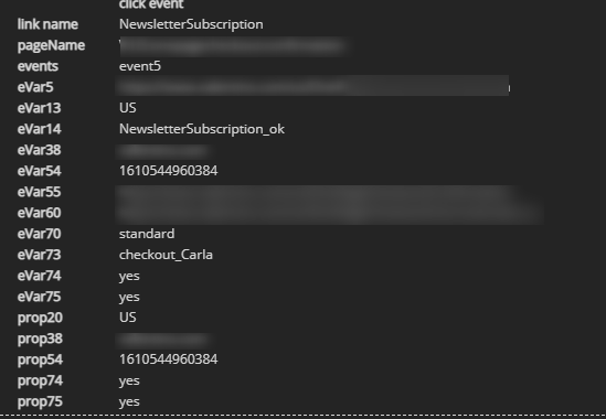

I have a hit that sends to adobe workspace an event (event 5) and populated an evar (evar73 = "checkout_Carla").
I'm pretty sure that there is only one call that trigger the event and the evar but, when I compare the event and the evar instances in the workspace I see a different name 1.389 (Event5) Vs 3.676 (evar instances)
How is it possible? The only solution is that the evar is sent in another called?

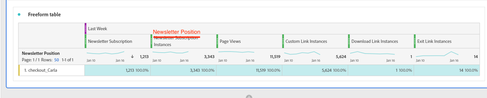

thk for reply, it set always record event https://www.screenpresso.com/=Cq5Gg 😞
Breakdown your eVar by Custom Link. Does AA report any other Custom Links besides "NewsletterSubscription" (the "link name" value shown in your screenshot)?
If i using custom link the number is equal https://www.screenpresso.com/=NN7xd how is it possible?
@francescop47742back in your original table with "Newsletter Position" as the only dimension, what happens when you drag in the metrics "Newsletter Position Instances", "Newsletter Subscription" (i.e. event5), "Page Views", "Custom Link Instances", "Download Link Instances", and "Exit Link Instances"?
do you mean create this table https://www.screenpresso.com/=bEWNe ? I don't understand 😞
Erm, use "Newsletter Position Instances" instead of "Newsletter Subscription Instances".
What I'm trying to do is to see which metrics, when added together, result in your Newsletter Position Instances, i.e. the number of times that Newsletter Position got set. That will give a clue as to where else your eVar is being set.
Oh sorry! do you mean this one https://www.screenpresso.com/=4iCwf , right?
Yes, that screenshot show the correct configuration now. Based on this latest screenshot, I think it's safe to eliminate Exit and Download Links as possible cases that are also tracking eVar73 (though it looks like there are a few instances, but those could be edge cases that are difficult to eliminate).
