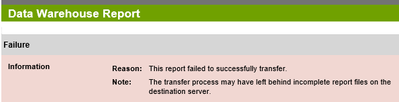

I'm re-querying the existing job w/ destination being GCP bucket, but for some reason it says "Error - Failure To Send" and the email notification received tells the below error. Could someone help what does this err mean and how we could tackle it?

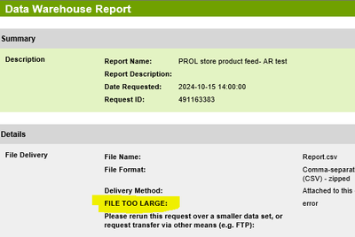

As an alternate when I tried emailing the report myself, the email notification stated FILE TOO LARGE for email. Wonder what the above err means!

There is a 10mb limit via the email delivery method, you may have to use an alternative delivery method like Amazon S3 bucket or Azure, etc. I personally use S3 bucket and it's pretty easy to get it set up.

@abhijithr, not familiar with GCP and wondering if there is any chance of a disk space limitation issue as well. As the original error message suggested, are you able to find any incomplete file transfer on GCP?
Two things I may try to test out
  • a smaller data warehouse request with the same GCP location, to test the location configuration and connection are all good.
  • same request to an old-school FTP location, to test if the data warehouse request itself and output data file size

Like the others, I am have not used the GCP bucket, but the initial error looks like there is some authentication issue... the error indicated that the file completed on the Adobe side, but wasn't able to transfer it.
As others said the file is too large to email, so that isn't a workaround for you.
Have you tried connecting to GCP Bucket using the credentials you provided in the Warehouse settings to confirm they are working?
@FarazHusain is right, if you contact Client Care, they may be able to run additional tests from the servers to try and test the connection to GCP Bucket.
