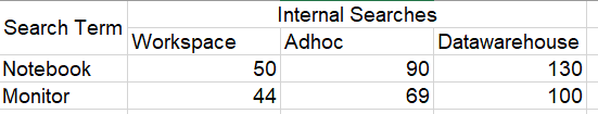

When breakdown by the search terms (evar or prop), I can clearly see differences among AA Workspace, Adhoc and Data Warehouse
Do you have any idea about the possible reason and how to make them aligned?

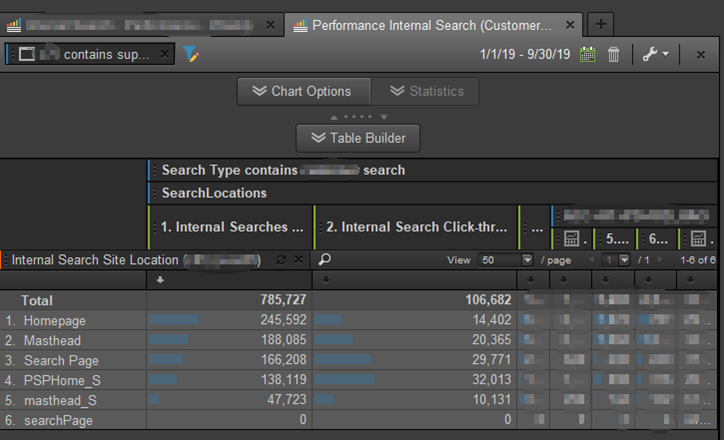

Take another example here:
In Adhoc, from 2019-01-01 to 2019-09-30, 780K searchs in total while 100K click-through.
In Data Warehouse, exact same segments applied in same duration, 3 million searches with 500K click-thourgh.
