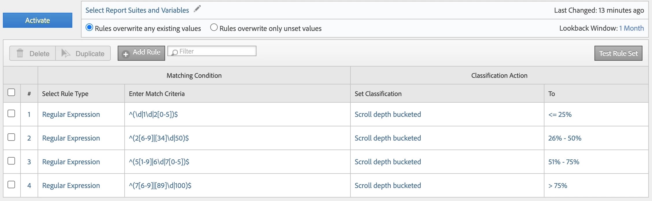

These are the classification rule regexes I typically use for this
  • ^(\d|1\d|2[0-5])$
  • ^(2[6-9]|[34]\d|50)$
  • ^(5[1-9]|6\d|7[0-5])$
  • ^(7[6-9]|[89]\d|100)$
it will not generate averages, but good enough to draw conclusions from it.

what may be an alternative approach could be using classifications to create buckets of scroll depth e.g., 0-25%, 26-50%, 51-75%, >75%
  • ^(\d|1\d|2[0-5])$
