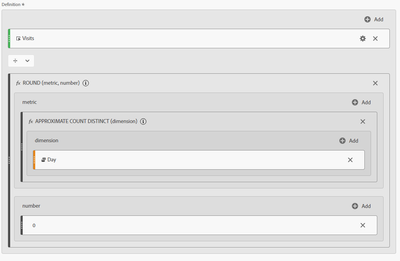

I would then suggest using a daily average calculated metric like so. You can use that as a metric for both experiences. This one is for visits, but you can just replace visits with page views at the top:

You can split this by experience using the out of the box experience dimension for that

I've built the calculated metric as you've shown but when i overlay my segment in a freeform table it shows exactly the same data as as if I were to swap out the calculated metric I've created and just add in visits.
