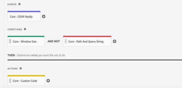

Do the logical conditions in Launch Regular or Exception allows DOM ready rules to exclude subdomains from main domain for rule firing?

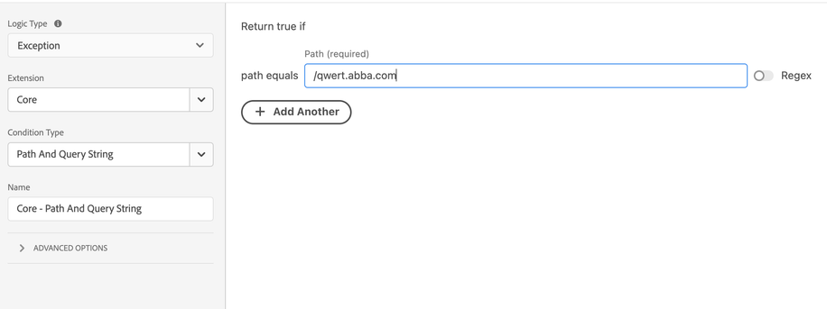

for example, my domain and subdomain have the same Adobe Launch environment code. And, I have one DOM-ready rule that I want to fire only for the main domain https://www.abba.com .. Can I exclude this DOM rule from firing on my subdomain https://qwert.abba.com like below (considering both domain and sub-domain has the same Adobe launch code on them):
Domain isn't part of the path... so that rule as you posted won't work...

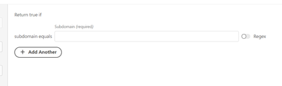

Subdomain allows you to enter the subdomain you are trying to match:
I have not used Subdomain myself, so if you have qwer.abba.com I don't know if you if you need to enter "qwer.abba.com" or just "qwer".... I suspect the first, but you should be able to test this condition quickly and make adjustments if it doesn't work the first time.

This issue just came up for us. In my testing, it required "qwer.abba.com" unless you toggle to use regex. Seeing the reply from @leocwlau, is there a reason you would use Custom JavaScript over the Core Component?
