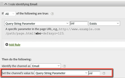

Also, I would like to inform you that if you are looking at the Marketing Channel data then use Marketing Channel as the dimension & use it along with the Marketing Channel Instances metric. In case if you want to break down the Marketing Channel with any other dimension then set that dimension in the 'Set the Channel's value to' from the Marketing Channel Processing Rule user interface as shown below.

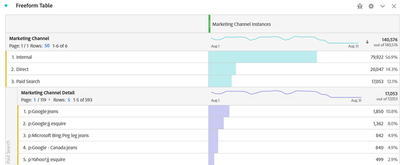

After setting the channel value you can breakdown your Marketing Channel dimension with the Marketing Channel Details dimension to get an accurate representation of how the Marketing Channels are getting attributed.
