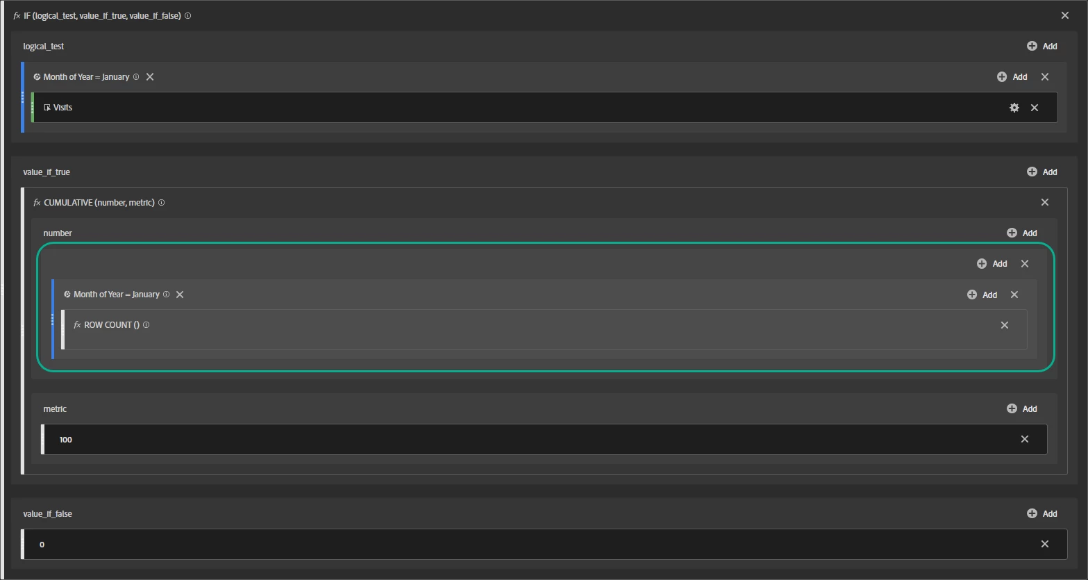

I am trying to create a calculated metric, which cumulate a static number based on month of year.
For example each day in January should add 100, but each day in February should only add 50.
I am using the IF function to control which month is in question.
For 'value_if_true' I have added the CUMULATIVE function. In the "number" parameter for the CUMULATIVE function I want to limit only the row for January. Unfortunately, if I add December to the time period it will cumulate 100 for each day of December as well.
If I try to make the "number" parameter dynamic, for example based on a function, for example "ROW COUNT()", then the CUMULATIVE function breaks down completely and do not return any values.
I have tried other functions in place of the "number" parameter and they all seem be broken.
Is this by design or have I misunderstood how to use the "number" parameter?
Thanks in advance 🙂
Best answer by yuhuisg
Here's something that I've learned about Calculated Metrics: they calculate based on the row-wise data. So your Calculated Metric is basically doing this: calculate the value for every row and return the Cumulative per row. But Cumulative should be the "outer" function, i.e. you want: calculate the Cumulative value from the value of each row.
Try this:
CUMULATIVE
  • number: 0
  • metric: IF
    • logical_test: (Month of Year = January) Visits
    • value_if_true: 100
    • value_if_false: IF
      • logical_test: (Month of Year = February) Visits
      • value_if_true: 50
        • logical_test: (Month of Year = March) Visits
So now for each row, AA should calculate your value from the month, then CUMULATIVE sums them all up. In the end, all of your rows will report that same CUMULATIVE result.

cgullestrup
February 3, 2022
Great thanks - that did the trick.
