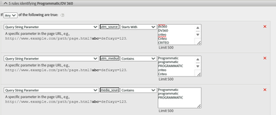

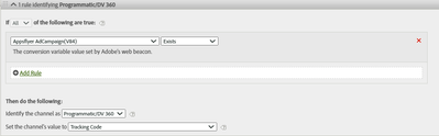

Hi @EurosIMS,
This is how we have implemented the Marketing Channel Processing Rule for the ‘Programmatic’ channel. This setup is specifically configured for mobile apps.
This setup is for Web:
Here is the Processing Rule configuration for variable v84, mapped from the context data:
The Challenge is when a user lands on the website from the URLs mentioned above, the First Touch Channel should be classified as Programmatic. However, it is currently falling under Direct.
Could this be happening because the deep link does not contain cid parameters or any af parameters which is causing the first hit to default into Direct?
Or could there be another underlying issue?
