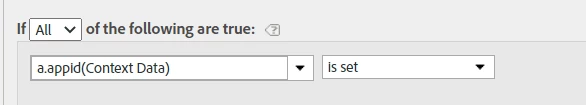

If you are using a Global Suite that is collecting both App and Web data, I like to make sure all my App Processing Rules have the condition (along with any specific conditions for the rule)
This just ensures that the rule won't affect my web traffic
