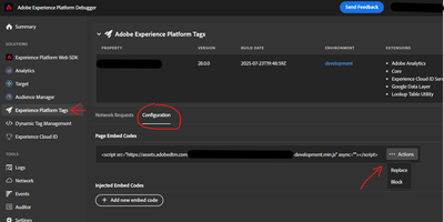

I am attempting to debug recent updates to my Adobe Experience Platform "Tags" (Adobe Launch) setup. I am able to get the debugger to inject the Dev library on a single page but when I navigate to another page on the same site, the environment jumps to Production. If I enter the first URL in the browser or navigate to the original URL, the environment jumps back to Dev.    What's a good way to force the Dev environment to "stick" no matter what page I navigate to as long as it's on the same domain I'm debugging?

Use the “Override Environment” Feature in AEP Debugger
Open the Adobe Experience Platform Debugger extension in your browser.
Navigate to your site’s page.
In the Debugger:
Go to the “Tags” section (under the left-hand navigation).
You’ll see the current environment (e.g., Production or Dev).
Click “Override Environment”.
In the pop-up:
Choose the Property.
Select the Dev environment from the list.
Click “Apply Override”.
The Dev environment is now injected across all pages on the same domain, even as you navigate
This override sets a cookie or localStorage key that instructs Launch to load the Dev library regardless of what is published live.
Thanks @gautham_madala  everything is going great until we get to the Override Environment step. Where is that?
I think there may have been a few steps missed there...
Still, I don't use this myself...  I don't want to constantly set this up each time... which is why I use a different, more robust solution...  but this should work for you.
