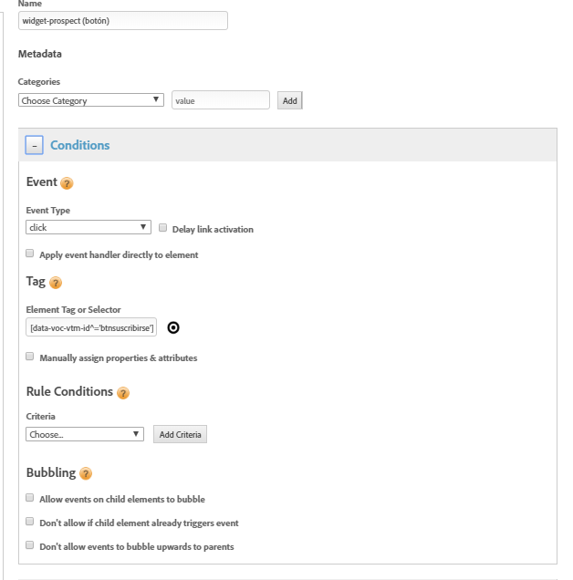

I am currently trying to fire an event through an event based rule. Since I was unable to do it by myself I have been searching the web and this forum in search for a working solution. On this very forum, I bumped accross a lovely post by @SarahEOwen (Track clicks on button using DTM ) which I have followed to the letter to no avail. I even followed the validation part of Sarah's post and believe it or not I did manage to get the prompt alert to fire on the console but I was never able to get the success event to fire hence me creating this post!
I am trying to get the event to fire on this site https://www.madridfusion.net/en/ on the SUBSCRIBE TO OUR NEWSLETTER module. Here is the tricky bit (at least it is for me ) Once you placed a bogus email (sort of oiaho@iogjh.com) in the email field you get a modal layer with a second clickable element. The first element is a button, the second one is type submit. Both of them have got an attribute by the name of data-voc-vtm-id so tried to get it to fire the rule using [data-voc-vtm-id^='btnsuscribirse-'] as shown below.
I also tried duplicating the rules one for click one for submit to no avail. Last thing I'd like to point out is that when using jQuery("[data-voc-vtm-id^='btnsuscribirse-']") on the console does indeed gets me back some results.

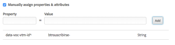

ok so if i understand you want a method to use for them all. What ever page this element is on this would then trigger your rule...
Try to manually do this or the like screen grab. The property and value are seperated...

Hello Pablo.
After trying everything under the sun I got so fed up that deleted the rule and started from scratch. This seems to have made the trick. In the end this is how I made it work.
Despite the fact it was a type input, it did work better with a click rather than a submit, also, I deselected the apply event handler check and selected the allow child elements to bubble.
In the end I did not have to go down the regex road which I'm very glad .
