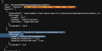

I took the freedom to have a closer look at your launch script.
From a high level, your "Page Load Complete - All Pages - AA - Page View"'s custom code could be
// seems to fail is message is not set
const eventInfo = event.message.eventInfo || {};
// -> change to
const eventInfo = event?.message?.eventInfo || {};
your "OneTrustGroupsUpdated" seems to be the culprit?

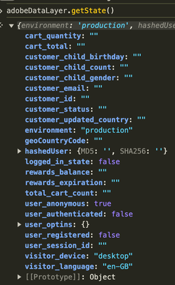

The problem I see with current setup is, that you do not persist anything from the "pageload.start" in the Adobe Client Data Layer's computed state.
This is because you throw all page-relevant information like page_name into the eventInfo object which is no longer accessible by the time your OneTrust event fires.

and in your custom code, instead of looking into the eventInfo, rather look into the fullState as well?
const pageMeta = {
    category: fullState.category || 'defaultCategory',
    page_name: fullState.page_name || 'defaultPageName',
    page_type: fullState.page_type || 'defaultPageType',
    title: fullState.title || document.title || 'defaultTitle'
just ideas 🙂

Ok, So I took today to look over our setup. Errors where made of course and we have cleared them up in our dev enviro. When they make it to prod I will report back.
Looking at the event send. The data is being set into an evar on the pageload.start event. This is working as expected now (too busy with other dev work to redo and QA Datalayer changes. But for now seems ok I agree to having it on the full state. This has cleared up the OneTrust error and and the TPS error. Also debugger is working properly.
What the main issue seemed to have been. In my haste I see that I was setting the Page Meta DE one way in pageload.start event then setting it for some silly reason on user.view (my only thought is maybe a copy paste since slip up since both DE's are set the same way. Cleared this up got rid of a ton of console errors in launch. I truly THANK YOU for your insights here and they were very helpful
