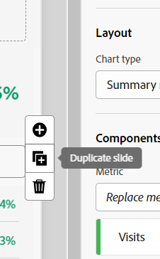

Add Metric 1 to the home screen as a small block showing an overview... now click on it, to pull up the associated screen and configure the look and feel for the overview. Now, hover over the middle right of the slide to see these options:
  • Add Slide
  • Duplicate Slide
  • Delete Slide
Add will add a blank slide, duplicate will start with a copy of what you just configured... in this new slide, drag in Segment A (re-label the slide to indicate the segment in use) and configure the display.
Repeat the process for the other 4 Segments. (If you duplicate, remove the other segment or stack segments depending on your needs)
Now, go back to the main screen and add Metric 2 (conversion metric), repeat the steps of creating slides with relevant segments.
  • Add Slide
  • Duplicate Slide
  • Delete Slide
