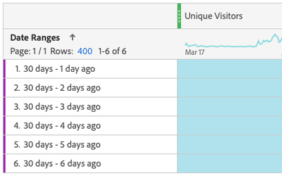

I tried to achieve history of cumulative UV for 7 and 30 days.
Jun 13th = .... UV in last 7 days and .... UV in last 30 days
Jun 12th = .... UV in last 7 days and .... UV in last 30 days
and so on.
I started with Cumulative UV metric for 7 and 30 days. However it gives me much larger values than ranged calculations. I suppose, it's because of duplicated visitors.
I also tried to create date ranges manually for last 1, 2, 3, 4, 5, 6, 7 days but I am not able to present such thing on line chart like with cumulative values.
Is there any better way to present how cumulative UV changes over time?
I think what you're doing with the manual date ranges is the best way forward. If you're not stuck on absolutely, positively 100% needing to show a line (or area) chart, you can use a (vertical) bar chart instead and still be able to see the trend.
