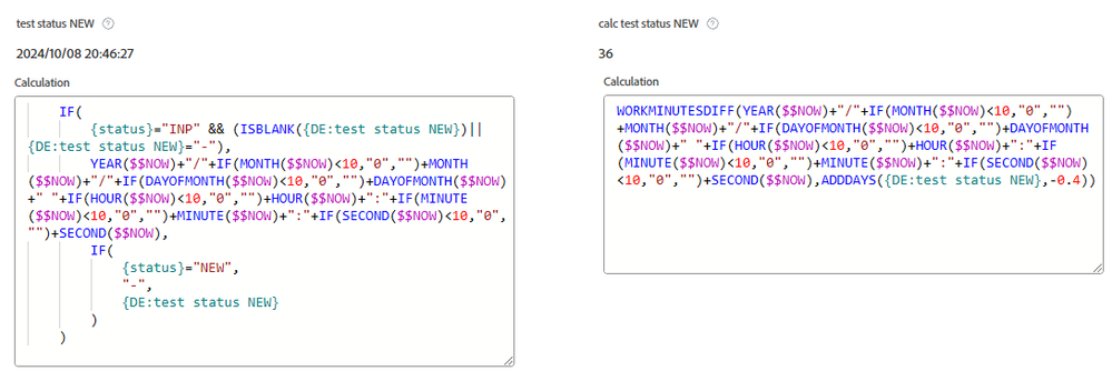

So you have to create a proper date/time string - both in the field where you set the time the status changed to NFU and when you compare that field to current time. It's ugly but works. In the screenshot you'll notice I "reset" the field to a dash (because setting to blank doesn't change the value) when you change the status to NEW. Depending on your use case you may want to do that - or not.
Last: I added an "ADDDAYS -4" because WORKMINUTES only get calculated during the worktime and it's after hours here 🙂
If you wanted the code
    IF(
        {status}="INP" && (ISBLANK({DE:test status NEW})||{DE:test status NEW}="-"),
        YEAR($$NOW)+"/"+IF(MONTH($$NOW)<10,"0","")+MONTH($$NOW)+"/"+IF(DAYOFMONTH($$NOW)<10,"0","")+DAYOFMONTH($$NOW)+" "+IF(HOUR($$NOW)<10,"0","")+HOUR($$NOW)+":"+IF(MINUTE($$NOW)<10,"0","")+MINUTE($$NOW)+":"+IF(SECOND($$NOW)<10,"0","")+SECOND($$NOW),
        IF(
            {status}="NEW",
and
WORKMINUTESDIFF(YEAR($$NOW)+"/"+IF(MONTH($$NOW)<10,"0","")+MONTH($$NOW)+"/"+IF(DAYOFMONTH($$NOW)<10,"0","")+DAYOFMONTH($$NOW)+" "+IF(HOUR($$NOW)<10,"0","")+HOUR($$NOW)+":"+IF(MINUTE($$NOW)<10,"0","")+MINUTE($$NOW)+":"+IF(SECOND($$NOW)<10,"0","")+SECOND($$NOW),ADDDAYS({DE:test status NEW},-0.4))
