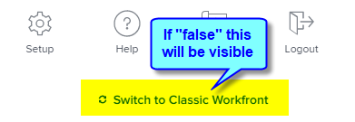

In case you'd like to double check that is indeed the case (or confirm your sinking suspicion that it is not), I invite you to log into your Workfront domain, and then in the URL of your browser, type the following (replacing yourdomain with your Workfront domain), and then hitting enter:
https://yourdomain.my.workfront.com/attask/api-internal/cust/currentCustomer?fields=isNewExperienceOnly
When the results come back in your browser, the last line will either show:
isNewExperienceOnly: true (Good: you are NWE only)
or
isNewExperienceOnly: false (Bad: you've not yet made the switch)
If the latter, I encourage you to speak to your SysAdmin (if you're not one yourself) to ask what the planned timing is, or if you are a SysAdmin, to contact Adobe Workfront (suspecting they'll soon contact you otherwise) to set the planned timing to switch.
