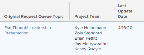

Hi Tegwyn, sure thing. This is a screenshot from the issue report I'm working on. "Last Update Date" is the column that uses the text mode code I mentioned in my initial post. Seems to work great except for the sorting issue.
displayname=Last Update Date
textmode=true
valueexpression=IF(ISBLANK({resolveProject}.{lastUpdateDate}),{lastUpdateDate},{resolveProject}.{lastUpdateDate})
valueformat=atDate
The Project Team column you see here is also text mode. It shows users on the project team of the issue's resolving project. I use this:
displayname=Project Team
listdelimiter=<div>
listmethod=nested(resolveProject.projectUsers).lists
textmode=true
type=iterate
valueexpression={user}.{name}
valueformat=HTML
"Original Request Queue Topic" is just the queue topic name field from the standard builder.
