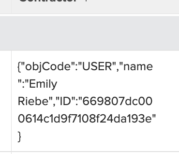

However the result spits out a line of code instead of just the name of the contractor?

this line
valuefield=project:Contracted Contributor #1
is your issue: a typeahead field contains that small JSON object you see printend.
To get the NAME, do similar to querysort line:
valuefield=project:Contracted Contributor #1:name

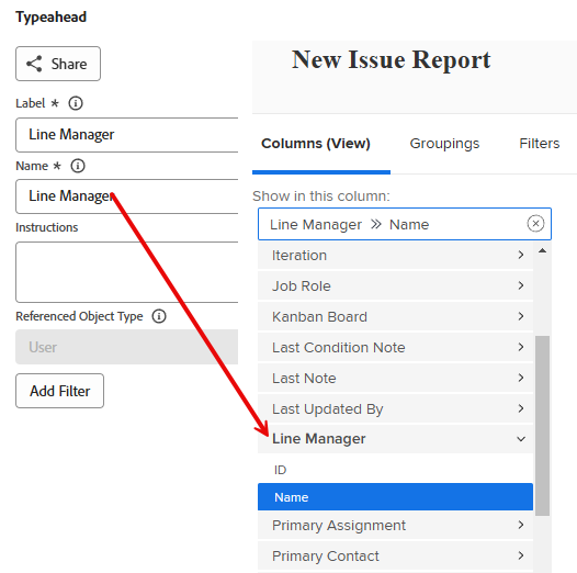

If you get out of text mode, all typeaheads are listed as objects by field name and the selectable attributes are ID and name.
