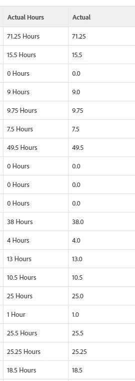

Hi everyone,
Could someone help me with the following simple text?
How do I remove the Hours text from the results column, so that it only returns the numeric value without the text?
displayname=
linkedname=direct
namekey=actualworkrequired
querysort=actualWork
textmode=true
valuefield=actualWorkRequired
valueformat=compound
viewalias=actualworkrequired

khrycAuthor
February 3, 2023
thanks Sheri, but that unfortunately didn't work, and it removed all values, so the column is now blank.
I'm looking for it to appear as 00.0 instead of 00.0 Hours
Any ideas?
Sheri_WhittenCommunity AdvisorAccepted solution
February 3, 2023
Hi Sheri,
Thanks for looking at this, it is a project report. Here is what I get when I try:
Got it. This was tricky and the credit goes to @kynabaker16, who solved it in this post Remove the string "Hours" when creating a report..
Here's what worked in my project report:
displayname=Actual
linkedname=direct
textmode=true
valueexpression=DIV({actualWorkRequired},60)
J_Mas
February 3, 2023
Try this in Text Mode (it's worked for me):
displayname=Task Actual Hours
textmode=true
valueexpression=CONCAT({task}.{actualworkRequired}/60)
khrycAuthor
February 3, 2023
thanks James...this didn't work either...it just returned zero on every line.
