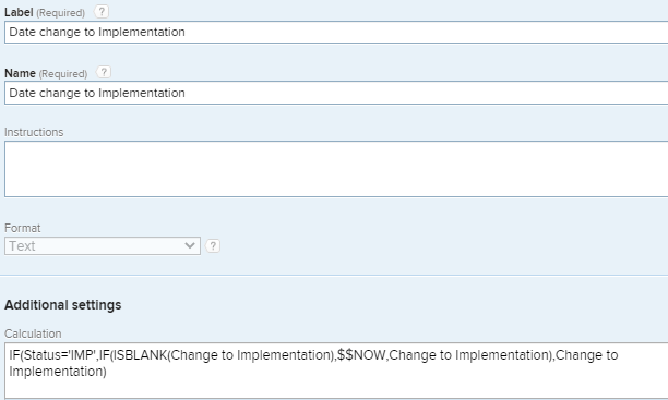

This is the calculated field that we use - IF(Status='IMP',IF(ISBLANK(Change to Implementation),$$NOW,Change to Implementation),Change to Implementation)
In this case, we had to create a new custom date field that we called 'Change to Implementation'. This needs to be done/saved prior to adding the calculated field. The calculated field will populate the date field when the status changes to Implementation, of course substitute any of the status keys, CPL, IDA etc., you would need. Keep in mind that this will only work when that status is changed once. So you can't toggle back and forth between status without clearing the field every time.
Hope this helps.
-Daryl

Daryl,
I created a calculated field "Changed to Assign". I did not put any logic into that field.
I put the text mode into the project report - but I got no value.
displayname=Date in Assign Status
textmode=true
valueexpression=IF(Status="XQC",IF(ISBLANK(Changed to Assign),$$NOW,Changed to Assign),Changed to Assign)
valueformat=
Did I misunderstand what you did?
Slightly, 'Changed to Assign' should just be the name of a date field on a custom form that is attached to all projects. Once that is done - on that same custom form, create the calculated field with IF(Status="XQC",IF(ISBLANK(Changed to Assign),$$NOW,Changed to Assign),Changed to Assign) as its value. Save the form and test by moving a project to Assign and reviewing the custom form of the project - the field 'Changed to Assign' should have todays date in it.
