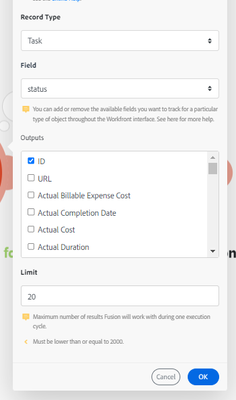

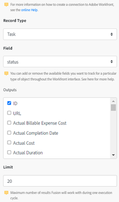

Hi @Sven-atClient , thank you for your response, here's my 1st module. This is actually my trigger functioning as watch field for status change.
Hi @A_EN - sorry: you sent the module definition.
I meant the little white bubble with a 1 in it 🙂 It will show what the input to the first module was.

Hi @Sven-atClient, Here it is. I was trying to figure out this issue by myself, but it gives me so much headache. 😄 I was only running single task to this project to isolate further but the same result.
