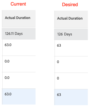

I'm trying to display the Actual Duration on a Task report in whole numbers of days. My text mode below is including the first decimal.
Any help is appreciated!
aggregator.displayformat=minutesAsDaysString
aggregator.function=SUM
aggregator.namekey=actualduration
aggregator.valuefield=actualDurationMinutes
aggregator.valueformat=intAsInt
displayname=
linkedname=direct
querysort=actualDurationMinutes
textmode=true
valueexpression=ROUND(({actualDurationMinutes}/60)/8,0)
valueformat=compound#M:D
viewalias=actualduration

I may be wrong, but give either of these a try for your value expression, I think your next-to-last paren just needs to shift:
valueexpression=ROUND(({actualDurationMinutes}/60/8),0)
valueexpression=ROUND(({actualDurationMinutes}/480),0) - since you were dividing by 60 (minutes in an hour) then by 8 (hours in a day) you can replace that with just 480 (minutes in a day)
Thanks Heather! I tried both and I'm still getting the same result.
I found some another article that helped me solve this. However, it doesn't include the "Days" label now.
My (nearly) final text mode:
valueexpression=ROUND(DIV(WORKMINUTESDIFF({actualStartDate},{actualCompletionDate}),480),0)
valuefield=dateVariance
valueformat=doubleAsString
aggregator.valueexpression=ROUND(DIV(WORKMINUTESDIFF({actualStartDate},{actualCompletionDate}),480),0)
aggregator.displayformat=compound
aggregator.valueformat=doubleAsString
aggregator.namekey=datevariance
displayname=Actual Duration
width=50
description=Total Task Hour
textmode=true
usewidths=true
shortview=true
Final result
Final text mode:
aggregator.valueexpression=CONCAT(ROUND(DIV(WORKMINUTESDIFF({actualStartDate},{actualCompletionDate}),480),0)," Days")
aggregator.valueformat=asString
shortview=true
textmode=true
usewidths=true
width=50
