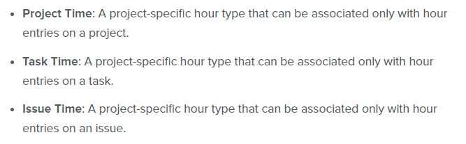

We'd just want the new CapEx option to show up in addition to the default "Project Time" option (which is showing up in our system as 'General' scope, even though the article you mention says it should be categorized as 'Project Specific' -- which would solve this problem -- is that possibly a bug? It also says Task Time and Issue Time should be Project Specific but are showing up in our system as General.) From the article:
