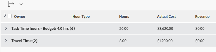

Best I can do is a grouped HOUR report (here based on hour type, but you could also group by checking source.name=Travel)
