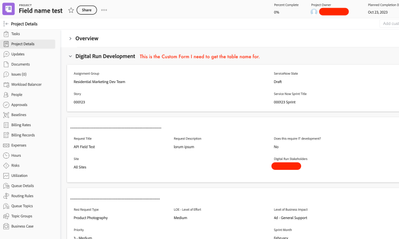

I am working with another team to get some base development to connect custom fields on a custom form in Workfront to similar fields on ServiceNow. After a fair bit of trial and error, I was able to get the custom field names, but I am being asked by our internal dev lead what the table name is for the fields that I have found.
To make it a bit clearer to understand, we have a request queue that is utilized at an enterprise level for a majority of projects. When we convert the request to a project, a custom form called Digital Run Development can be added with a specific template. So, once converted there are three sections on the Details section: Overview, Digital Run Development, and the enterprise custom form. I need to see the table name for the Digital Run Development. Because when I make a field name request for the custom fields, all I can see is the name and ID of the test project I created and I don't see anything that indicates the Digital Run Development custom form.
Custom Form from converted project that I want to see the table name for when I am in Postman:

Technically the table name is whatever object the form is attached to (so PROJ if it's a project, OPTASK if it's an issue, or TASK if it's a task), but I don't think that's what they're really trying to find. You also won't see any reference to the custom form that is attached, unless you are specifically looking for it and pulling the categoryIDs field, but you can see the fields on the form contained in the parameterValues collection. Can you clarify what they're trying to achieve with that information?
