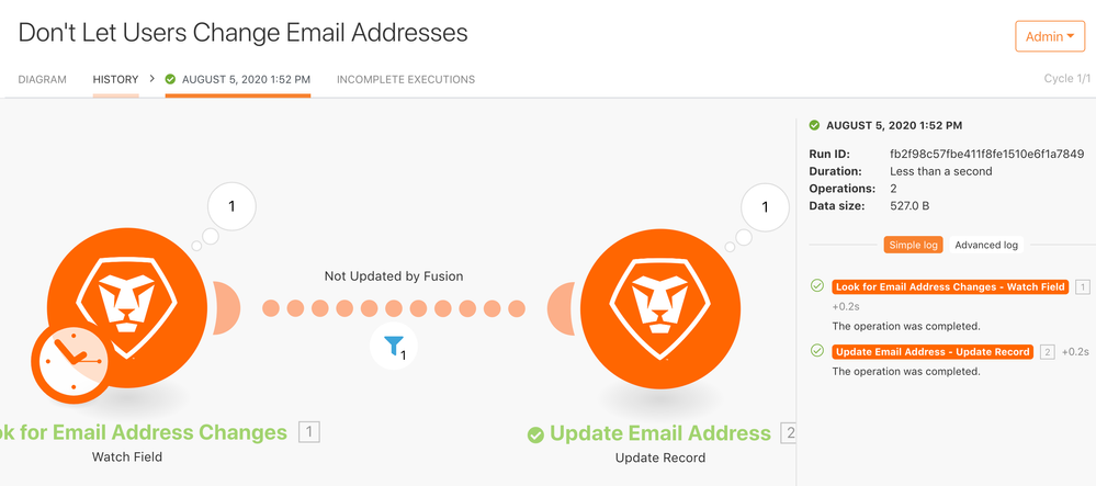

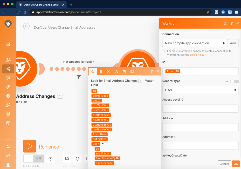

I've setup a simple example wherein I am initiating a scenario (in Fusion 2.0, but could also occur in 1.0) based upon looking for changes to email addresses (Watch Field Module), then simply performing an update to the user to set their email address back to what it was previously. (Update Record Module).
In this instance, it's very important to include a special filter between the two modules which looks to make sure the "Last Update By ID" is not equal to the User ID that is assigned to the "Fusion user". This prevents you from entering into an "infinite loop" (e.g. look for changes to email address, find one, update email address, that counts as a change to an email address, so it updates again, and so on).
See attached screenshots for an overview of what the scenario looks like. 0690z0000097dHtAAI.png0690z0000097dHyAAI.png

Thanks for this reply. Do you also happen to have the update screenshot? We are working on trying your solution and got stuck on the update details. Thanks!
