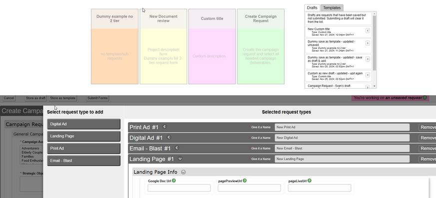

I prototyped something that makes the intake form more modular but this will require Fusion and Web development. DM me if interested.

I feel like part of the challenge is that the request / custom form paradigm doesn't allow a parent request (eg the campaign) to get filled out at the same time as the child requests (the campaign tactics).
A huge custom form is a pain to maintain, and you'll have to set up duplicate fields (tactic type 1, tactic type 2) etc.
If you wanted a tactic to have its own form, you could create a project off the campaign request and then have a queue with the tactics, but that means users have to do more work (and a license is needed)
A client asked us to provide a custom solution where campaign details AND all tactics can be submitted in one fell swoop. Think of it as a request queue/form that itself has a queue, so a 2-tier request form.
The client has Fusion, and the resulting form submission is then handled by creating a project for the campaign, and the tactic requests inside it. It's a mini web app to present the UI based on custom forms, and Fusion as the engine to create the needed WF objects.
