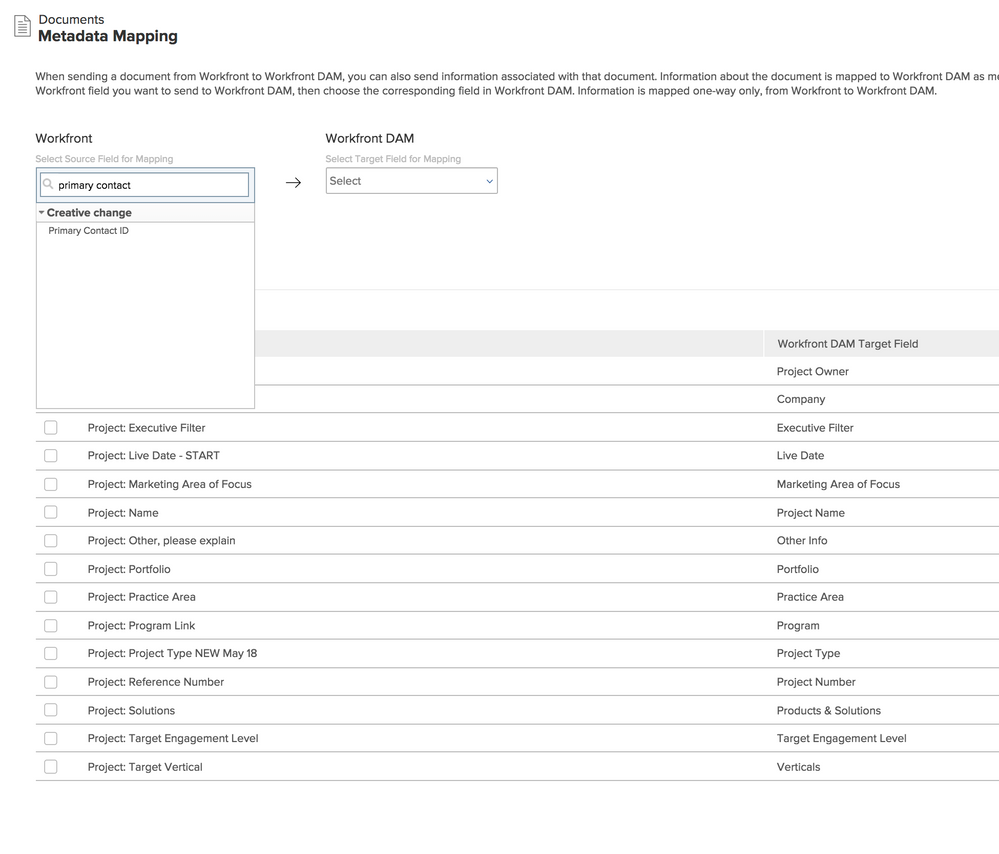

Hey Stephen and Narayan, This is very helpful, as I have a similar issue I have not been able to find any help with. I would like to pass the name of a creative change/issue requestor through to the WF DAM, however there is not a system field that is mappable that contains the name, only the ID. I have tried to pass this information by mapping the Primary Contact and project Sponsor fields (both of which have the requestor's name), but there are only ID fields for each, no names. I am thinking I will have to create a calculated field on a custom form to capture that information, and it seems like your solution above would work. However, I am very inexperienced at text mode, so I was wondering if you would be able to share a couple more screengrabs of how exactly you have this setup (and what goes in each text mode for both the request/issue custom form and the project custom form). If I can get the name to appear as a custom form field on the project, I can then map it to a corresponding field within DAM. Thank you very much for any help you can offer! Jason Semall Sr Creative Ops Mgr Conversant
June 11, 2018
Screengrabs of the fields I referenced. Jason Semall Sr Creative Ops Mgr Conversant

Thanks Polly! The document(s) that I am passing to DAM from WF are posted to the project that the issue/request is converted to, by a designer. So, if they are the ones pushing their document from the Project to the DAM, I think they would pass through as the "owner" of the document, no? I am trying to find a way to capture and pass through the name of the person who created the issue/request that is then converted to the project that the final documents are then attached and passed to DAM from. That person is always the Primary Contact on the issue/request, but that system field doesn't seem to pass through when converted to a project, and only appears to be an ID when I try to map to DAM. It is also part of our process that when issues/requests are converted to projects, the person who requested it is always made the Project Sponsor. This also only returns an ID option rather than name when trying to map to DAM. I was hoping there was a way to create a calculated field that converts an ID to a name within a project, like Narayan and Stephen were describing for a project report, that I could use to pass to the DAM. Thank you again for your help! Jason Semall Sr Creative Ops Mgr Conversant

Hey Polly! Thanks again for your input! It is greatly appreciated! Let me step out our process so it is a bit clearer: Marketing Manager submits a request/issue via our queue Each request/issue has a custom form attached that contains the information captured Project Manager receives request and converts the request/issue to a project The request/issue custom form is then transferred to the project Designer is assigned tasks and completes the work. When complete, they post the final deliverables to the project under Documents tab. They then send the asset to the DAM When sending to the DAM, any of those fields from the custom form attached to the project can be passed to DAM attached to that asset I have been able to map all of the fields from the custom form that I need, except for the name of the Marketing Manager who made the initial request/issue - the system fields that would give me that information are both only ID's (Primary Contact ID and Project Sponsor ID), not names. I am trying to avoid having an open text custom field on my form where they have to enter their name, but that may be the only way. I am very interested to learn more about the solution you described. When you say "done thru coding," what exactly do you mean? What was your process for implementing? Jason Semall Sr Creative Ops Mgr Conversant
