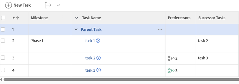

If you are using predecessor relationships, you can add a text mode column:
displayname=Successor Tasks
listdelimiter=<p>
listmethod=nested(successors).lists
type=iterate
valuefield=successor:name
valueformat=HTML
