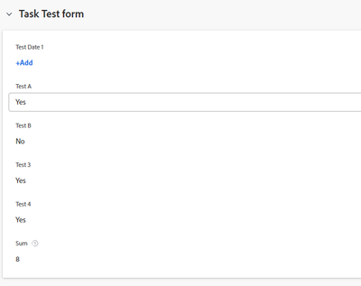

ChristineZh2,
It does look like your instance may be having an issue. I setup something similar to test my calcs come through fine without the NA. I used your calc and just updated my field names and it works fine. It seems you've done everything right.
