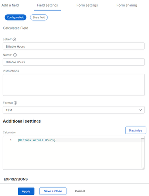

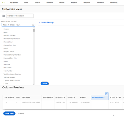

hi @AndyConsolini
1) Create a calculated field name "Billable Hours", follow below;
2) Go to task level, attach custom form to the specific task or all task.
3) GO to view and recall calculated field as shown below;

hi @AndyConsolini
