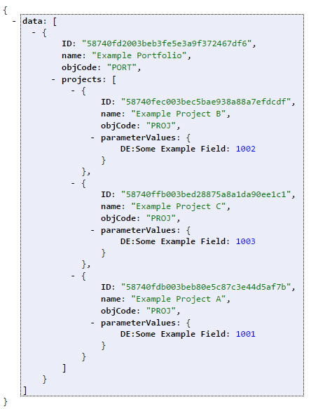

I'll use the search syntax for these examples, but you can also use the direct REST calls as well.
Example: /attask/api/PORT/search?ID={ID}&fields=projects:parameterValues
This says, "For the Portfolio with this ID, give me it's collection of projects. On those projects, also return me the parameterValues (custom data field values)" - Screenshot attached.
In my screenshot, I only have one field on the Project custom form. If I had more than one, all would be shown. Let's say there was only one specific field you wanted to return that existed on each project. You can instead ask directly for that field. Since my field is named "Some Example Field" ... /attask/api/PORT/search?ID={ID}&fields=projects:DE:Some%20Example%20Field ... would also work. "DE:" is the identifier for your Custom Data.
