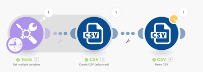

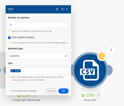

I'm attaching a blueprint that you can import and test the functionality of the CSV create/parser mechanism.  Hopefully this helps show you how it works.  If you still have problems, I'd recommend creating an isolated scenario like this that reproduces and then post the blueprint here.
Here's the overall pipeline:

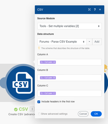

Each of the configs for the modules:
Note that I added the quotes, newlines, and commas in Column C just to be as complex as possible.Note that I added the quotes, newlines, and commas in Column C just to be as complex as possible.
The fields in the data structure as just Text type, nothing fancy.The fields in the data structure as just Text type, nothing fancy. Screen Shot 2024-01-26 at 11.44.47 AM.png

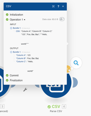

 And here's what the test run shows:
Note how the input values match the ultimate output values.
