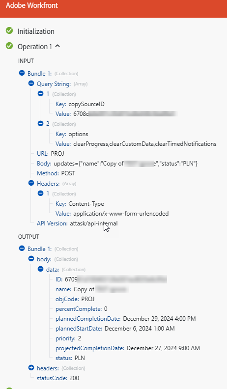

So here is the deal:
Using a customAPI module you can duplicate a project.
Method: POST
queryString : 2 parameters
  1. copySourceID (the ID of the project to copy
  2. options: comma-separated list of zero-or-more of
    • clearAssignments
    • clearFinancials
    • clearProgress
    • clearApprovers
    • clearCustomData
    • clearTimedNotifications
    • clearDocuments
    • clearExpenses
    • clearPredecessors
    • clearPermissions
    • clearBudgetedHours
Body
updates={"name":"{the name of the new project}","status":"{the status of the new project}"}
The resulting bundle :

Hi Sven,
I have just tested this and it worked!!
Thank you so much.

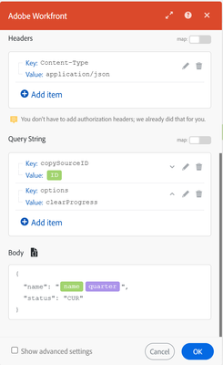

Hi @Sbhuta ,
Try to pass this in body it works for me ...
In my scenario name of the project should be modified by adding info at the end and status as Active.
